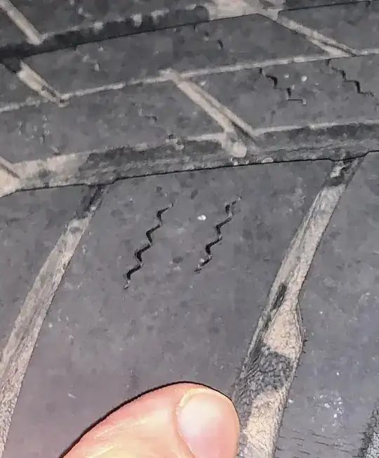

Edit: tire condition: enter image description here

I think you have 2 separate problems, both due to having hit a curb:
  1. The pulling to the left and the wheel not being straight sound like a problem with your alignment. If it was just pulling to the left having a sticky brake caliper on the left side could be an issue, but the fact your wheel isn't straight when you are going straight means a brake problem is unlikely
  2. The vibration issue is likely that a wheel has become unbalanced, or perhaps you dented a wheel when you hit the curb
The solution is to take it to a tire shop that does alignments, have them do a full alignment and check the wheels' balancing.
