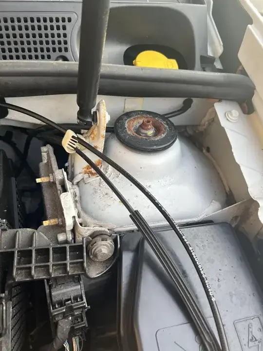

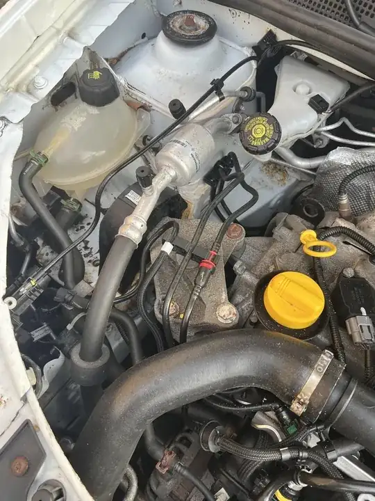

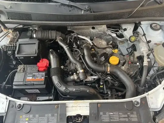

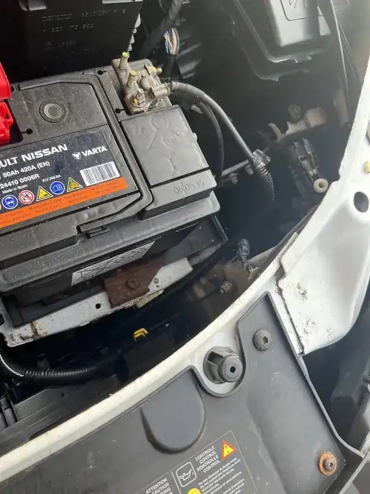

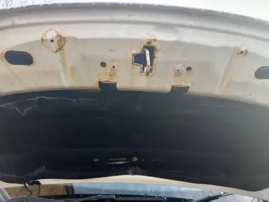

Hi everyone who is reading this. I have a white Dacia Sandero 2015 with around 56k miles on the clock. I believe it needs a new clutch but after looking under the bonnet I am a bit concerned about the rust under here. Some advice would be useful :). I wouldn't want to spend more money on the car if it doesn't have long left and would fail an MOT anytime soon for rust. enter image description here enter image description here enter image description here enter image description here enter image description here

  • The bonnet is not structural, so rust would not be an MoT failure unless it had significant holes showing on the outside, in other words, a sharp edge in case of collision with a pedestrian. Your bonnet is many, many years away from that stage
  • The structural areas in the second picture - the chassis rail, strut top mount and bulkhead appear to be in perfectly good condition, although we can't see them from underneath
  • I assume the subject of the third photo is the battery clamp. This would only fail the MoT if it no longer held the battery down, i.e. if it were missing or had rusted through completely. It's made of metal thick enough that this won't ever be an issue. The usual problem here is that the bolt rusts and breaks when trying to remove it to change the battery, but that can fixed or worked around
  • In the fourth and fifth photos, the same applies as to the second photo above, so nothing here appears to be of any concern
