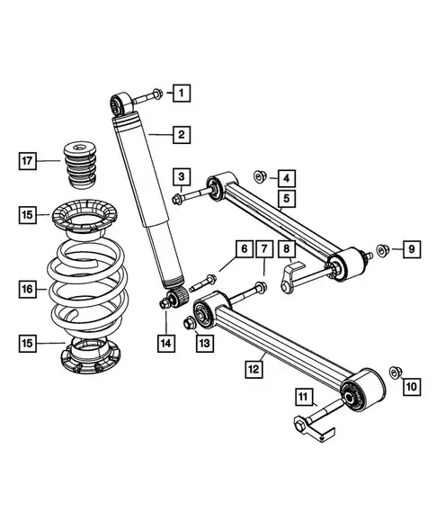

I'm trying to find a bolt for a rear lower control arm on a 2008 Jeep Liberty. The closest I have been able to find is https://parts.thomascdj.com/v-2008-jeep-liberty--sport--3-7l-v6-gas/rear-suspension--rear-suspension-and-cradle
Rear Suspension
#11 is a bolt with I'm guessing a retainer clip on the side. The site lists out all the part numbers...except #11. My clip broke when I tried to remove the bolt. I haven't been able to get a good grip on the clip side and I'm planning on cutting it if I can't remove it.
My question is, do I just use #7 on both sides? Can I just go get any Grade 8 bolt that fits for this? The arm is snapped and I have not bought a replacement yet, but I don't see any indication the bolts come with the control arm.

I found the original part number as 6508678AA, which has been replaced by part 6507620AA, or #7 in this picture.
