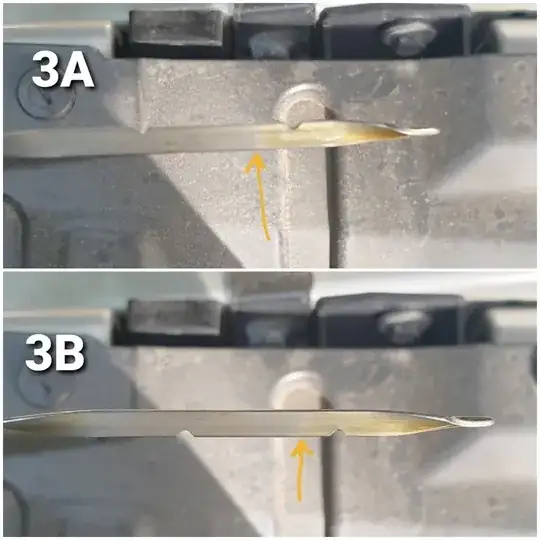

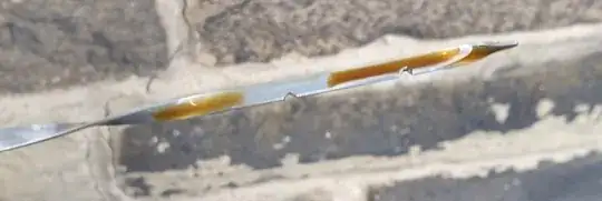

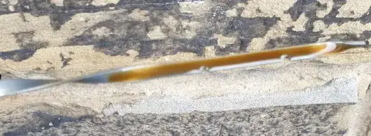

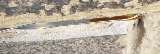

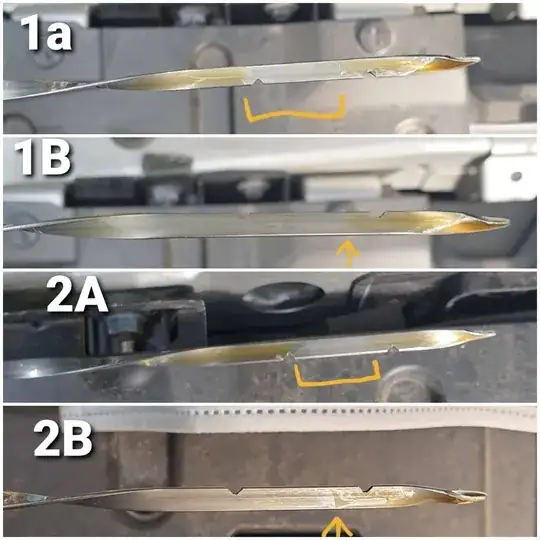

Update: I have since driven the car, parked it on a flat, returned 30 minutes later and did 3 dip stick checks one after the other. I've attached pictures. In 1 and 2, side A has a gap and oil well past the max line. Side B stops where the gap starts on side A. On the third attempt, Sides A and B are the same (inline with 1b and 2b). I am thinking B is the reading I should use and top up oil accordingly. Would appreciate opinions

It appears to both the top and bottom images show the actual level between the two notches. It appears in the third image the dipstick has picked up some oil from the tube where the twisty is at. To me there is that "distinct line" there as well as it matching up to the amount of oil said you put into the engine. IOW, it makes sense.
