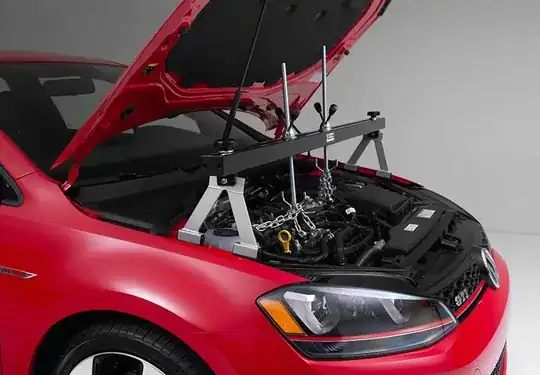

One way to support the engine without a jack to remove the motor mount is by using an engine support bar. I've used one for a timing belt change when the motor mount had to be removed. The photo below shows how it works. You could make something like this out of lumber, a threaded rod and some chain, or you could possibly rent one. Photo credit: ECStuning.com
