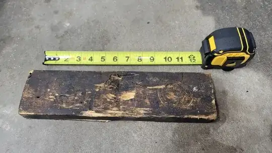

Just for reference, here's a piece of 2x4 which I've used for MANY years doing exactly this kind of work:
As you can see it is beat to heck ... but guess what? It's still structurally sound. I would use it in a heartbeat to do the same job again.
