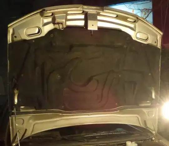

Yesterday, I made a mistake when I was jacking up my car. The bonnet was open vertically and I didn't notice it is close to the ceiling. I jacked up the car slowly and saw some white material is falling down! It was chalk of the ceiling. Upon close inspection, I discovered the bonnet had penetrated about 10 millimeters into the ceiling but not stuck. I lowered and inspected the bonnet and didn't see any sign of damage but when I closed the bonnet, it didn't align perfectly with the lines of right and left fenders. Now, bonnet seems to sit a bit higher than before. Is there anything I can do about it or should replace the bonnet? I haven't adjusted any bonnet before.

Adjust the bonnet hinges - you may be lucky with the holes having enough play.
