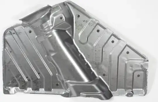

The one I'm concerned about is the one under the fuel tank. When I look at how it is sculpted, I feel that keeping the fuel tank cool is only one of its design parameters. It also has channels that seem to lead any leaking fuel away from the exhaust pipe, with the drainage holes quite far from the exhaust pipe.
fuel tank heat shield
The idea then, presumably, is that even a drop of fuel (from a crack, from a tiny hole, from rust, or from stress fracture during a minor collision) will instantly ignite if it touches the exhaust pipe, possibly leading to a catastrophe (such as starting to bake the occupants inside or, worse, the tank exploding). A fire there seems risky because the driver will not even know, unless good samaritans happen to be nearby and honk like crazy.

The rationality of this is, if the manufactures spent the money to install it, it most likely serves a very important function. The function may not be obvious to us at first, but many times it surfaces it's head when after 20,000 miles or so we discover scorched wiring or overheated fuel or hot floorboards. If the shield is available, it is always a good idea to have it replaced. Sometimes you have to get a little inginuitive with securing them, but then you know they are protecting whatever.

Immagine:
  • A protective measure that separates a very hot surface from a liquid tank, often in precarious state.
  • The liquid tank contains, at average, 60 liters of a highly inflammable liquid.
  • The hot surface is a few centimeters under the container.
  • The liquid has an ignition point around the temperature of the hot surface.
  • Attached is at least one human being, in an enclosure, one or two meters apart from the container. The enclosure is lined with flammable plastic.
  • The whole system is travelling at around 130 km/h, around other similar systems.
Nobody sane will tell you that said "protective measure" is unnecessary, at least in written.
