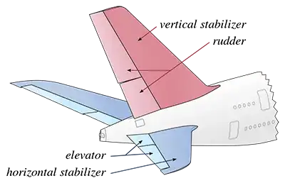

You always fit the best tires on the rear. Why? They don't motor*, don't steer and barely brake - why can't rear wheels just be casters?
The rear tires are your rudder
They keep your car from spinning out. To be technical, they provide stability in yaw, and they don't steer, so vertical stabilizer is more correct. Ever seen those on the front of an airplane? Nope, and for good reason!
enter image description here src
Driving a curve (and some other things) put sideways force on every tire. Here's the key question: In poor traction, will your front or rear tires break away first?
If your front tires break first, your car will seek to go in a straight line. (understeer). As it gets near breakaway, you'll notice - the steering will be less responsive. If you are properly trained, you will "turn into the skid" (align the steer wheels with the direction you are actually going). Why? Wheels have best sideways traction when rolling straight - when cocked at an angle, traction is much worse. By aligning wheels with the skid, you get maximum traction and soon recover control. (and of course this will correct the rear problem too.)
If your rear tires break first, there is nothing you can do about it. You can't steer your rear wheels into the skid. The increasing angle makes traction even worse - a vicious cycle, which is why a spin-out is hard to stop! I've spun 360 on a tight cloverleaf freeway on-ramp going 25 mph in simple rain. That's when I grokked the "rudder" thing, and put my best tires on the rear.
Best tires go on the rear because you want the rear to break away last.
