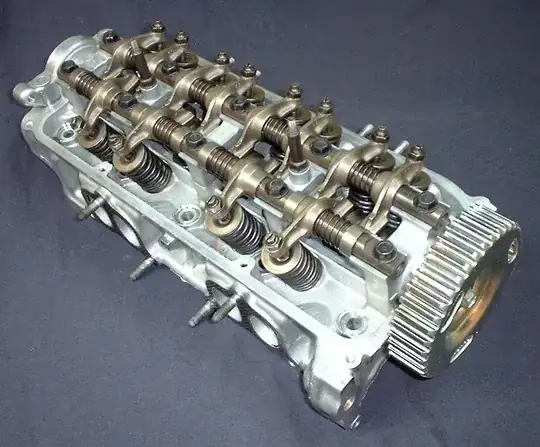

As for the configurations themselves, in SOHC configurations, the camshaft is placed on top of the head. Here is an example:
SOHC Head Picture pulled from Google Images
The wheel at the right of the picture is what the cam belt rides on. This wheel is attached to the cam itself. The cam, then actuates the rocker arms which you can see are pointing to either side of the head. This is an example of a 3-valve per cylinder head (2-intake and 1-exhaust per cylinder). The 2-valve per cylinder is a much mor prevalent configuration.

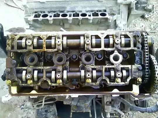

Here is an example of a DOHC:
DOHC image pulled from google images
In this example, you can see there are two separate cam shafts riding atop the head. For DOHC heads, the cams can be tied together with a short chain, then have a separate chain/belt which drives the cams, or can have just a single chain/belt which runs the whole thing. DOHC engines usually have a configuration of 2-intake and 2-exhaust valves per cylinder, but in some cases like the configuration Volkswagen-Audi Group (VAG) uses a five valve per cylinder (3-intake and 2 exhaust). In most cases, the cam directly actuates the valve without the use of a rocker arm (it may or may not have a "lifter" between the cam and the valve).
