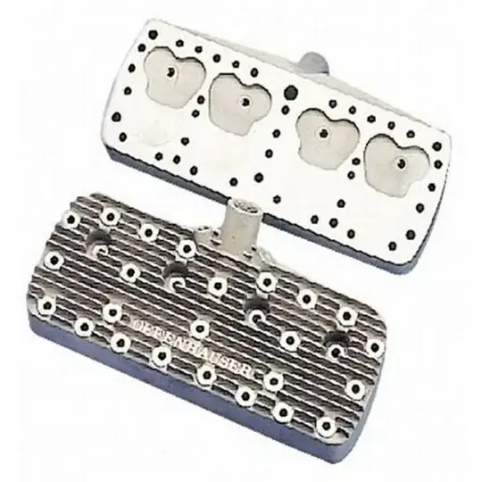

  • Flathead Cylinder Head - These cylinder heads were used on older engines such as the flat-head Ford engines (like seen below). The oval protrusion at the top of the cylinder head is for coolant flow. Coolant would flow up from the block and through passages in the head (between bolt holes) and out through this oval port at the top.

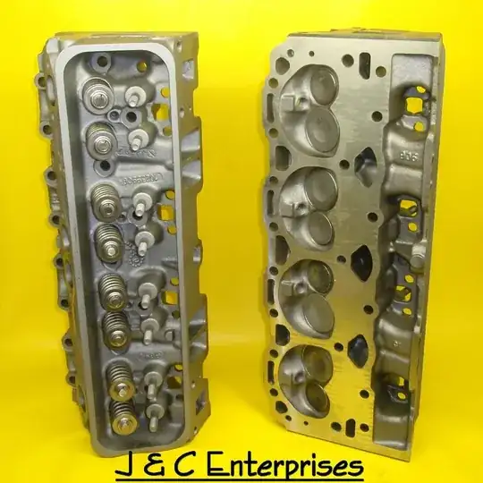

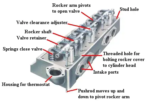

  • Overhead Valve Head (OHV) - This type of cylinder head has been used extensively from the 1950s and are still used today. These heads have the valves located within them instead of in the block like the flathead. The valves are actuated indirectly from the cam through a valve train, which usually consists of lifters (tappets), push rods, and rocker arms. An OHV head usually looks something like these Chevrolet heads below. In the picture, the flat surface of the head (right side of the image) is the portion which faces the engine block. The left side is where you see the valve tips, valve springs, retainers, and keepers. On top of these is where you would see the rocker arms if they were installed.

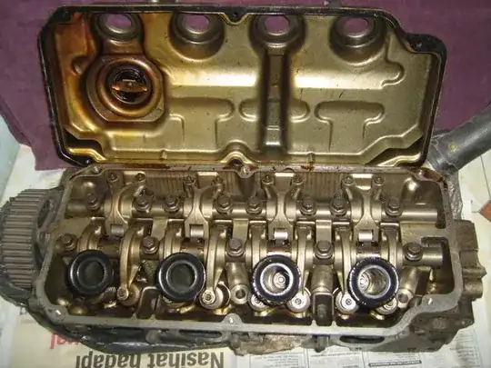

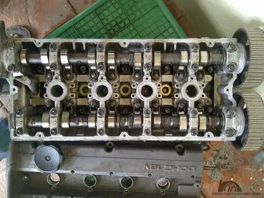

  • Overhead Cam Head (OHC) - This third type of head usually has the camshaft co-located with the cam. It is called "over head", because the cam actually resides over the top of the head. The OHC can have a single (SOHC) or dual (DOHC) configuration. (You can learn more about the differences between a SOHC and DOHC in this SE post). Here are some images showing OHC heads:
    In this image, it is a little hard to see, but there is one camshaft (you can see the single gear to the left of the head) which extends the length of the head. This single cam shaft actuates both the intake and exhaust valves which are in the head.
    In this image of a DOHC, you can see the two cam shafts (find two gears to the right of the head in the image). with DOHC, the valves can be actuated directly (as in this image) or with the use of rocker arms.

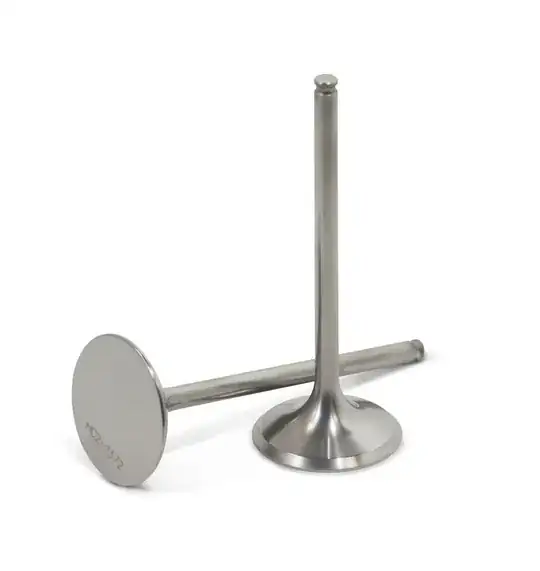

  • Valve: Usually buried inside the head, this is the part which lets the air/fuel mixture into the combustion chamber and the exhaust gasses out during that portion of the Otto cycle. The valve is actuated at the precise time by the cam shaft. Here is a representative image of a valve: enter image description here

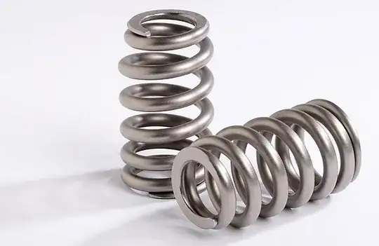

  • Valve Spring: This keeps the valve closed when it's not open. Valve springs can be comprised of one, two, or even three different spring portions (depending on the design need). Usually only very high performance engines need the spring pressures involved with three (or triple) springs. Here is a representative image of a valve spring (these are beehive springs, so called due to their shape): enter image description here

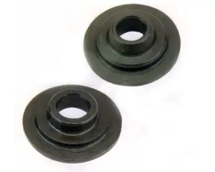

  • Valve Spring Retainer: The valve spring retainer keeps the spring located on the spring. The retainer is located on the top end of the spring (away from the head). It holds the spring in place while simultaneously attaches to the valve via retainer locks (see below). Here is a representative image of a retainer:

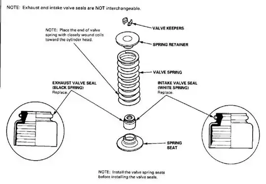

  • Valve Seal - The valve seal is located around the stem of the valve at the top of the valve guide (see below) underneath the valve spring. It provides a seal so as to prevent oil from leaking (or getting pumped) into the intake and exhaust tracts. Here is a representative image of a valve seal:
    In the image, you can see two valves (at bottom right and to the left). The valve seal is the spring which encircles the valve, the polymer piece underneath of it, and the metal which is below that.

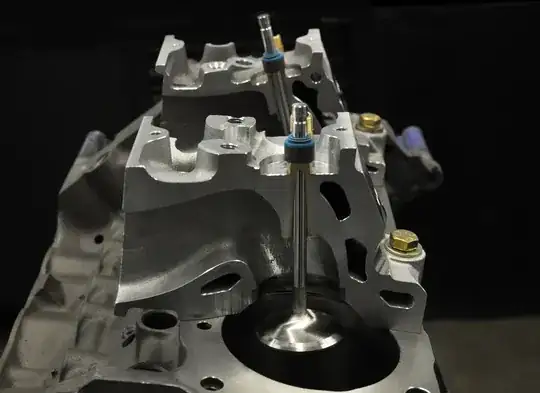

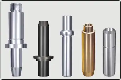

  • Valve Guide: The valve guide does exactly what the name implies - it guides the valve. The valve guide is a separate piece of metal usually made out of cast iron or bronze. The guide is separate from the head so as it can be replaced if needed when a head is rebuilt. It is driven into the head and provides a way to keep the valve specifically located while still allowing the valve to move up and down during the open/close cycle. There are many different types and different applications for each. Here is a representative image of different valve guides:

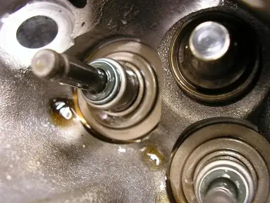

    In the image, I've added two yellow ovals. The valve seat is located between the two ovals. The seat is the portion which is discolored and looks to be machined at an angle. When the seats are place, a place is machined into the head where the seat will later be driven into it. Then the seat is cut at specific angles so the valve will make perfect contact with the seat and create a positive seal. You can also see in the image, at the center of the circles, is the valve guide peaking out at you.

    Here is an image of most of the parts described above and how they all fit together (blown apart, of course):

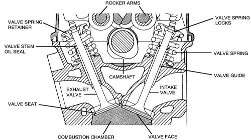

    Here is a very basic OHV head. You can see the different parts of the head annotated for better understanding. All head with valves in them work fairly much the same way, but can be arranged in different ways as you've seen in the above images. Here is another image showing the cross section of how the valves, intake runner and exhaust runner may be situated within the head:
