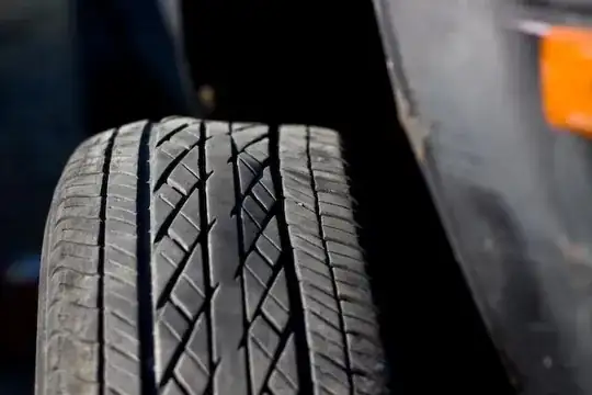

      • Broken Belt
        • When a belt is broken inside of a tire it will cause the tire to "bounce" since it is unable to keep it's form. Think of a tire without a broken belt as a baseball, and the tire with a broken belt as a stress ball. Below is an image of a tire with a broken belt. You can see the bottom of the tread is 100% worn while the top of the tire still has tread left. This was caused by the "bouncing" condition. enter image description here

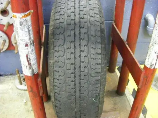

      • Slipped Belt
        • With a slipped belt in a tire it will cause the tire to "wobble" and the steering wheel to shake. Here is a image of a severely slipped belt. beltslip
