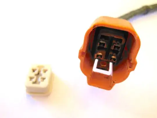

First, carefully pry out the white socket cover from the inside of the connector with a flathead screwdriver.
Remove white socket cover
This will expose the four pins and the tiny plastic tooth that latches into a hole in the flat side of each pin to hold it firmly in its socket.
Socket cover removed

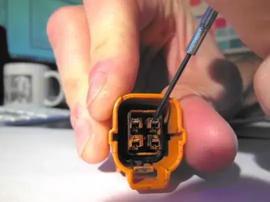

Use a flat jeweler's screwdriver to push the sensor pins (black and grey) slightly down so they disengage from the hidden tooth on top, then out through the back of the connector.
Pushing down on pin
Be very careful not to apply too much pressure until you are sure the pin has disengaged. If you break the plastic tooth, the socket will no longer hold a pin firmly.

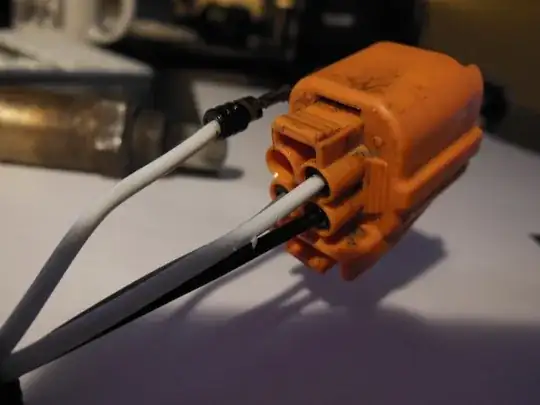

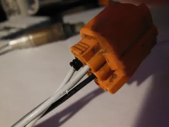

Pin disengaged
Pin removed
Repeat with the other pin, noting which pin was in which socket.

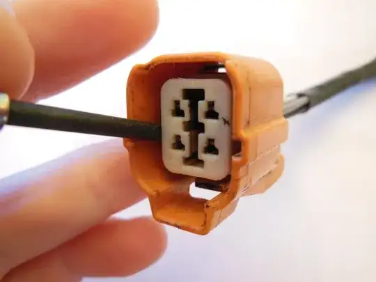

Reinsert the pins in opposite positions, pushing firmly so they lock back into the connector. You should be able to tug on the wire from the back of the connector firmly without the pin coming out. Snap the white socket cover back in with the original orientation.
