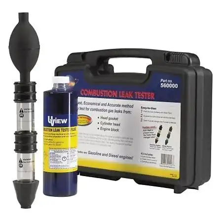

There is also an easy way to check the head gasket. They make a combustion gas leak detector that detects CO2 in the coolant indicating a leaking head gasket.
Uview Combustion Leak Tester
Here is a video of how it works
