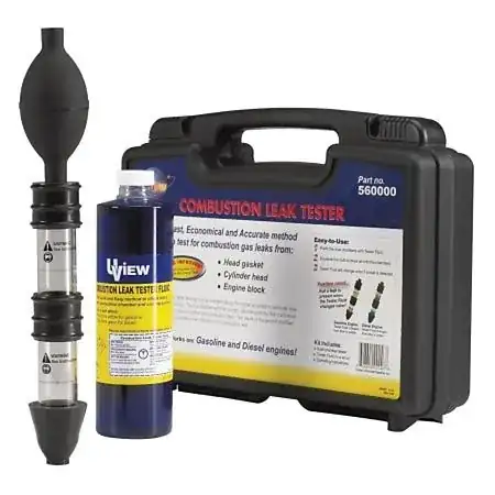

They make a head gasket leak detector kit to determine if it's leaking. I would be surprised if you mechanic didn't have one. If he or she doesn't they are not that expensive.
Here is an example below
