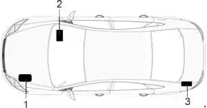

There are three fuse boxes for your car: one under the hood/bonnet on the driver's side, one under the glove box, and one in the trunk on the driver's side.
fuse box locations

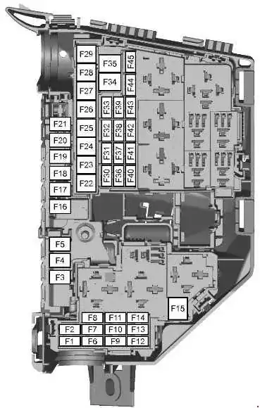

To get at the engine compartment one, you'll have to press on the side and top of this box, then lift the cover off.
engine fuse box
It'll look roughly like this:
opened engine fuse box
The fuses we're interested in are:
  • F39: 15 amp; Adaptive Front Lighting System (AFS)
  • F40: 5 amp; Headlamp leveling / AFS module
To my knowledge, those are all the fuses relating to the headlights. I could be wrong there though. More information is available here.
