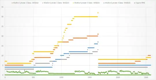

Electrical - I bought a cool little "ECU Scanner", and a pro version of some app that allows me to access the hidden parameters of the subi's computer. Specifically there's a little memory address that records when the crankshaft position sensor logs a misfire. The data returned was interesting.
(Update 1) I now have a cool graph of the results. (I've divided the RPM's by 1000 for readability)
  1. The misfires mostly only occur at idle, never when the car is above 1000rpm, think stop lights.
  2. They occur equally in all cylinders, which explains why I only get the P0300 and no codes for specific cylinders, they don't occur at the same time, but typically in quick succession to each other, each cylinder misfiring in a random intermittent manner at idle.
  3. (Correction)When the misfires are occurring, there is slight hesitation in the idle, like the engine is slowing ever so slightly.
So, I'm kinda stumped on this one, should I just move to the compression test? I have a good understand of what is going on, and when it's going on, but not the why it's going on, feels like I'm throwing things against a wall until they stick. Is there a better way to do this?
