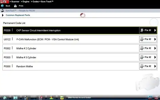

This one came in today with a check engine light on and a complaint of running rough and won't accelerate past 30MPH.
Checked the codes.

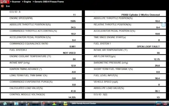

Some misfire freeze frame.
Reset and went for a test drive.
Codes P0300, P0302 and P0303 come back right away. scan data shows a constant misfire on cylinders 2 & 3. Engine doesn't actually run rough I think the customer confused the limp mode rev limiter with rough running.

Fuel trims look OK live readings weren't far off from the freeze frame. No vacuum leaks, all hoses secure and accounted for.

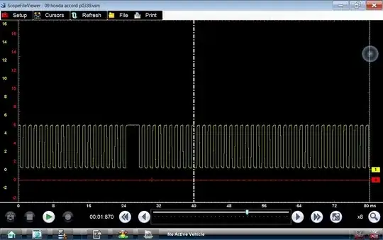

So how about that Crank Position Sensor code?
Looks OK to me. No drop outs. Signal looks clean. Connector is secure.

Fuel pressure? Around 50psi, good enough for me. Great. So how about that Crank Position Sensor code? Looks OK to me. No drop outs. Signal looks clean. Connector is secure.
Nice graph, looks normal.

Having ruled out actual misfire and seeing no current failure of the crank sensor a different approach is needed.
My next move is to check and replace battery, repair any voltage loss to starter as needed to resolve the slow cranking problem. Then reflash per TSB 09-050. Perform crank relearn. Then retest.
I chose this route because you stated the engine was not running rough which I take to mean there is no actual misfire felt or seen in scan data while running. And the codes set immediately after the start. which is the condition covered by the reflash. I see nothing particularly unusual in the freeze frame data. Looks like most Hondas of this era 8 seconds after start.
