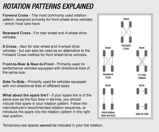

Yet, this highly voted answer to Tire blew out at 15K miles, should I replace just one tire or a pair by a high-rep user includes the following (un-sourced) graphic showing "recommended" tire change patterns:
This seems to indicate that moving tires between sides of a vehicle is not only acceptable, but outright encouraged.

There is some history to the answer.
The popular type of tire used to be what is known as "Bias Ply" tires, named for the way the layers of the tire were constructed. Once these tires were installed and driven on for a while, they were not supposed to be reversed. Running them in the opposite direction was bad and could lead to tire failure (Citation needed. This is hearsay passed on to me.). Rotation was therefore done only front to back and not left to right.
Now most tires are steel belted "radial" tires. They don't have the same construction, and it is safe to change their direction of travel. It's safe to swap them left to right, so that is recommended to move the tires all around the car over the course of a few rotations to even out the wear.
The caveat of that, is that we also now have a lot of tires with a directional tread pattern. These treads are designed to move water or provide traction better when they are rotated in a certain direction. There's no structural reason that you can't change direction, but you will mess up the handling of the tire. So, if your tires have directional arrows on them, they should only be rotated back to front.
The chart listed in the other answer would have been used with non-directional tread patterns in mind.
This image from Khumo Tires explains a little more:
http://kumhotireusa.com/tire/basics/tire-rotation
