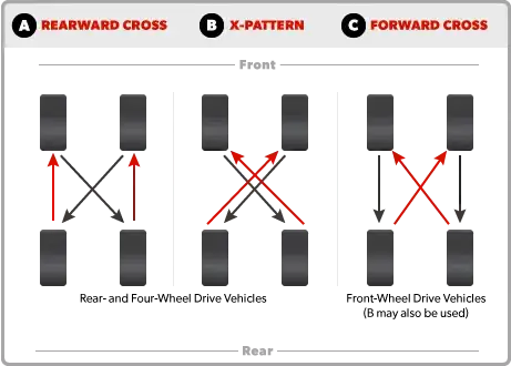

If you cannot find a completely identical tire, replace two tires (left+right on the same axle) and from this point on, use a tire rotation pattern that maintains the property that both new tires are on the same axle. So, alternatively on rear axle and front axle. Usually the recommended pattern is to swap front and rear, and on one of those swaps, swap also left and right. Pattern a and c here are such ones:
