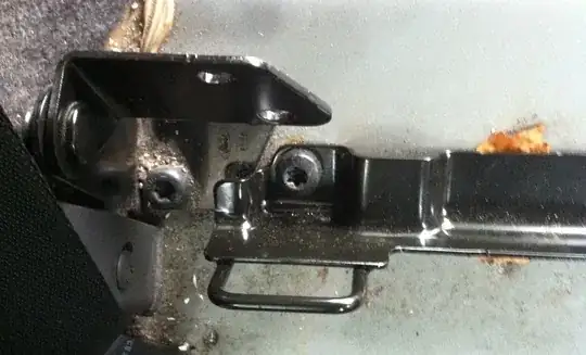

I wanted to fit the brackets on the smaller seat, behind the drivers side (in a UK, right hand drive car).
For my late 2005 model Focus, Mark II I think, UK registration "XX54" there was nothing on the door side hinge to lever up with a screwdriver (as per many instructions out there), instead the back seats came out according to these instructions on the Focus Fanatics forum.
The rubber/plastic bungs for the threaded bolt holes are then obvious under the line of the rear seat back, and comparatively easy to remove with a screwdriver. The bolts for the Isofix bracket can then be fitted with a Torx bolt (T50):
Isofix bracket in place in a Ford Focus Mk II
