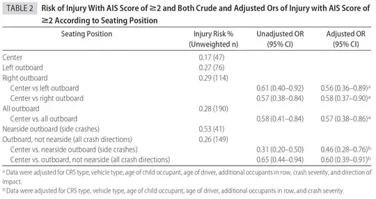

My understanding is that the safest position in a car accident is the centre of the rear seats. For example this paper finds that 0-to-3 year old "children seated in the center rear have a 43% lower risk of injury compared with children in a rear outboard position."
Risk of Injury With AIS Score of >2 and Both Crude and Adjusted Ors of Injury with
AIS Score of >2 According to Seating Position
