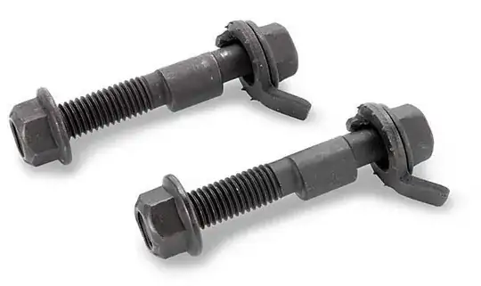

In your vehicle the strut mounts to the knuckle with two big bolts. When these bolts are loose there is some wiggle room. This wiggle room is how camber is adjusted in your car.
If the wiggle room is not enough (assuming nothing is damaged) you have two options. The bolt holes can be oblonged by grinding. This will give you more wiggle room. The other option (better option) is to get a special bolt that has a built in eccentric. This gives more adjustment and allows the adjustment to be more easily controlled. You will have to figure out what bolts are available for your car. enter image description here
