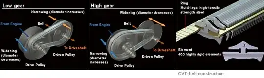

Using the pictures from the Nissan CVT overview site:
You can see that there are two variable diameter pulleys connected by a very robust belt. As you say, this theoretically allows for an infinite number of gear ratios. Practically, there are plenty of engineering and human interface limitations that reduce infinity to a more manageable set of presets. There is a finite resolution of the pulley adjustment mechanism that allows the engine computer to direct the transmission. This means that, while not quite infinite, you probably have many many more effective gears settings than the five choices I have in my car.
