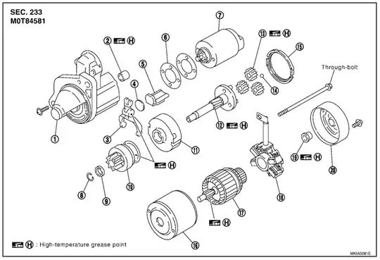

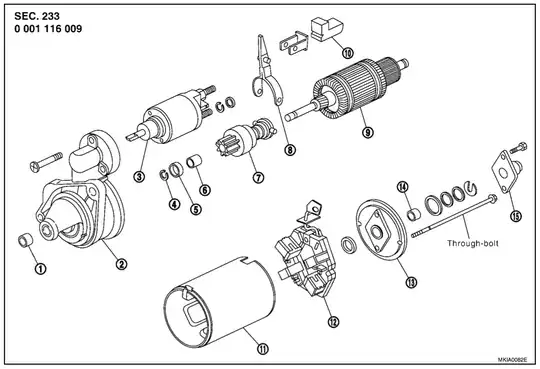

I've been lucky enough to find a workshop manual, and it shows two different diagrams for two different starters. I'd like to get an idea of what specifically the issue could be, and what would be required to fix it.
Can this be as simple as cleaning and lubricating some of the gears?

I could be that simple. A binding solenoid/mechanism can cause what you are experiencing.
Looking at the top image, the solenoid (#7) is on top of the starter. When power is added, the solenoid moves the (#3) arm which slides the gear (#10) out to engage flywheel. When power is removed, the solenoid and gear should snap back. Lack of lube can cause this to bind or move slowly.
All the lube points marked with an H are important. As you can see, many of the points are where that gear slides and associated items related to it.
