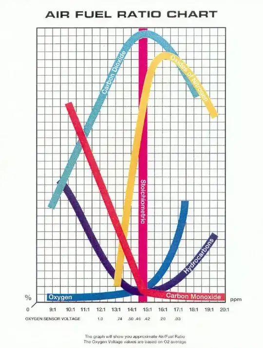

Refer to the graph below for with help with gas value interpretation. The left side of the chart is rich and the right is lean.
Gas analysis graph
Of the list of possible failures the MAF is a possible cause of a rich condition. Fouled plugs would result in much higher HC due to misfire. Low compression would likely be corrected for by a properly functioning fuel control system including an accurate MAF reading. Oil in the combustion chamber does not greatly affect combustion gas values until it gets to excessive amounts. Failures of the PCV system do usually present as lean run problems.
