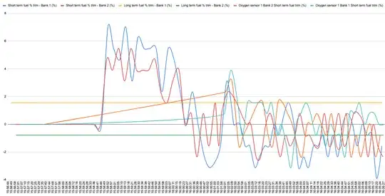

Edit: Coolant temp once warm stays close to 200 deg. Add Chart image of OBDII readings Long & Short Term Fuel %

  2. MAF: As you say you smoke tested your intake I'll eliminate that as a possibility, so it's worth cleaning the MAF. It's actually pretty low down on my list of likelihood, however it's very easy to get at and clean so you may as well eliminate that. Check that it's giving accurate outside air temperature readings, you can see the values using an OBD reader
  3. O2 sensors: although your upstream O2 sensors may be working electrically they may not be delivering accurate data to the ECU
