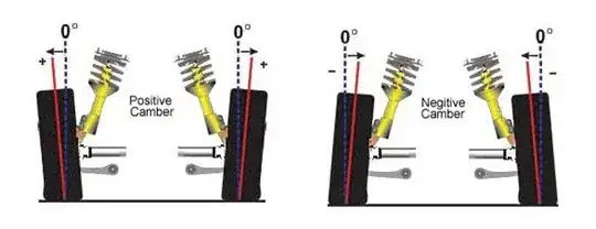

Camber is the amount of lean in or out the top of the tire has. The following image describes it pretty well:
Wheel Camber Explained
And as you can see from the image, the process of changing the struts, could change the camber if things are not put back correctly. Before you end up wearing an odd pattern into your front tires I would suggest having the front end aligned.

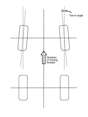

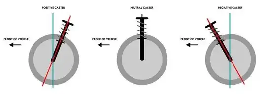

Additionally, toe or caster may have been changed. This diagrams below show what each are.
Toe Defined
Caster Defined
If the toe is off you could easily be driving down the road straight, but the wheel is off center.
