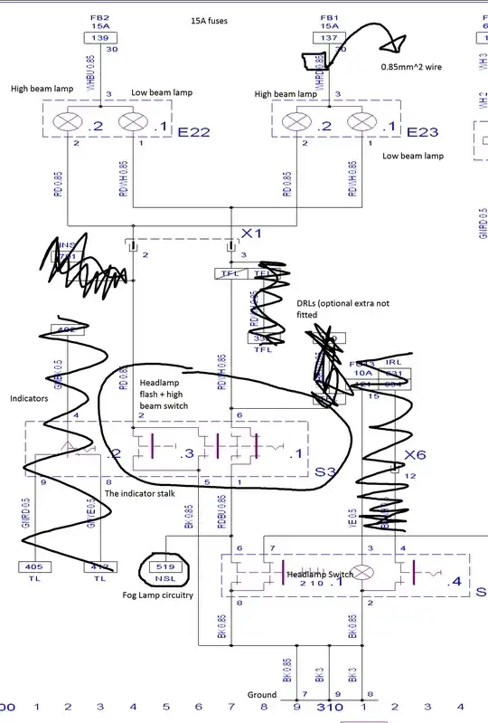

My 2003 Opel Agila has 0.85 mm2 wiring for the entire headlamp circuits. I want to install higher wattage bulbs, up to 110 W. It takes H4 bulbs so the high and low beams are combined into one bulb.
I have included the wiring diagram for reference:
Enter image description here
However, when I googled, I found some stories of the stock wiring melting when using higher powered bulbs. This would obviously be a disaster!
As they've used 15 A fuses, I assume the maximum power from each side is 15 A * 12 V = 180 W for each side, so I assume it'd be okay, but I don't really know.
Note there is one fuse for each side, so each side can draw 180 W.
Will my wiring be able to cope with this sort of power?

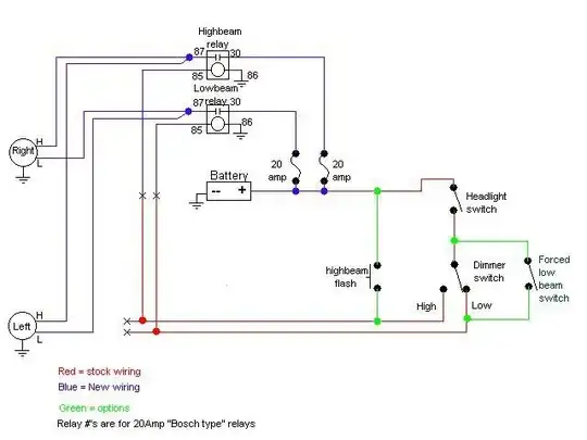

A common strategy when upgrading lighting is to use the car's original wiring to control relays that carry the actual power for the lights. The relays are installed close to the battery and the wire run to the lights is kept short and made with wire sized for a low voltage drop. New fuses are added to protect the load circuits through the relays. You can take a look at my answer to this question for a longer discussion about fuses, but the bottom line is that common practice is to size the fuse to protect the wiring.
The wiring diagram below, from this question shows the changes necessary to upgrade to relays. The diagram is for a Ford truck, but concept is right. The parts you're interested in are the blue changes, the green are unrelated modifications to the headlight circuit. Also note that on this truck there is one relay per side (high and low) whereas your car would be wired with one per beam. Also your car is switching the ground side of the circuit rather than the hot (+12V) side.
Wiring diagram, showing relay upgrade

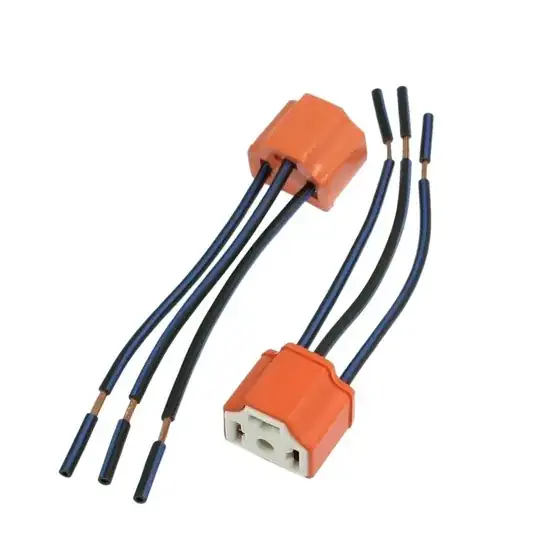

Since the lamps you're planning on installing consume significantly more power than the original one there is the distinct possibility that the fixtures themselves will not be up to dissipating that much heat. In particular, be concerned about any plastic parts. At the very least you probably have plastic housings for the bulb terminals, it would be prudent to consider upgrading to ceramic ones. They are commonly available and not too expensive. I was able to find these on Amazon by searching for "h4 ceramic headlight connector".
Ceramic H4 lamp connector
You can also find bare ceramic ones (without the orange plastic covers).
