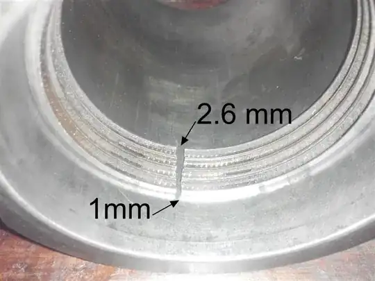

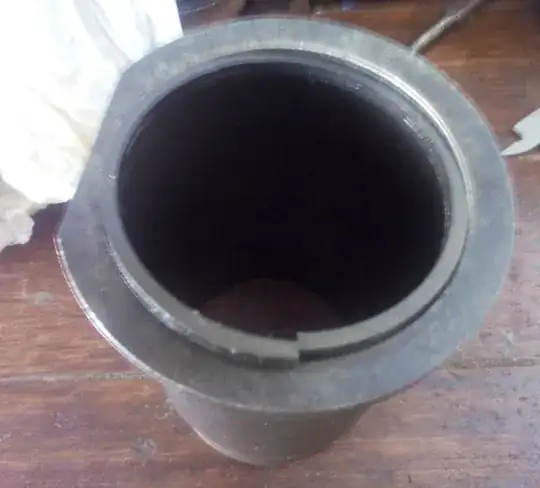

I'm adding some photos here:
Black rings don't fit, but I can file the endings to make them in:
New "factory" oil rings with uneven gaps. I put them together for the picture, so we can see how different gaps they have.

if they are 30+ years old were they kept in oil or some other anti rust / corrosion preservative? if not make sure the rings are still good.
Are these gaps with the new cylinder sleeves? if so then your rings are undersized for the sleeves and you may need bigger piston rings and possibly an oversized piston as well or you need to get different properly bored sleeves. Then if the rings are too tight you can shave them down with one of those small ring grinders.
I would get properly sized rings. I would not use the factory ones which you cannot grind down to the proper size. Are the "black non factory" rings the originals or aftermarket.
Can you upload a picture of all the rings and the rings gap when installed in the cylinder?
I am assuming you are measuring the gap while the ring is in the cylinder
holy cow that is a huge ring gap. How does the ID of the new sleeves measure compared to the ID of the old ones?
wait a minute that bottom image of a cylinder liner, one with all 3 rings in it, looks used are those the new ones you purchased?
It looks like you have factory spec new rings with used bored and then used again sleeves. The black ring looks like it may have been an aftermarket oversized ring. Go measure near the tops (under that small wear lip at the top) and near the bottoms (above the lowest point the top ring goes) usually this means near the middle but not always. do this for each new cylinder liner and each old cylinder liner. Give a list of top and bottom measurements for each. you can then see, if it's readable on the package, how oversized the black rings are and if the factory rings are at all. also post the factory stock id of the cylinder liners. sorry really late so I might have rambled but I hope I get the thought across.
I thought so. those factory rings are probably for brand new sleeves. A 1MM gap is pretty big and will leak oil and allow a significant amount of blowby. Are you sure you cannot find anyone with oversized rings? and I am assuming you have not bored out the cylinders and they are worn.
