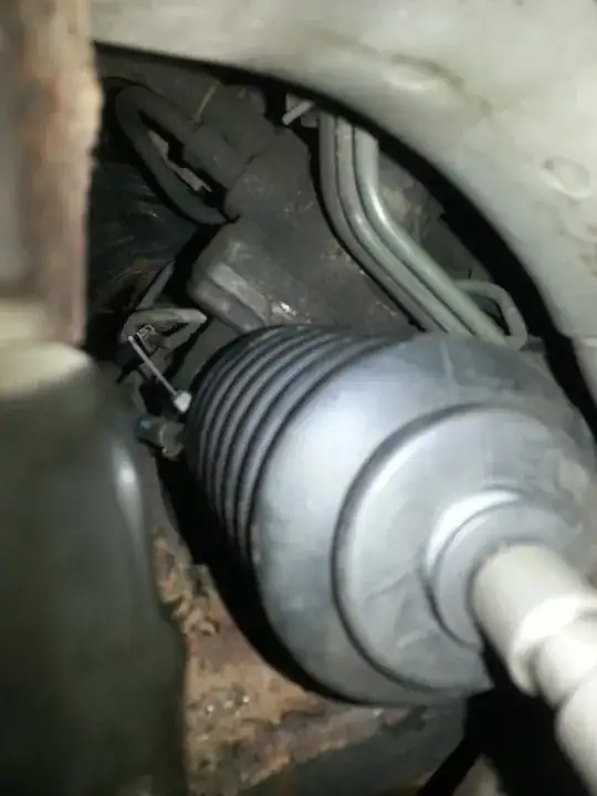

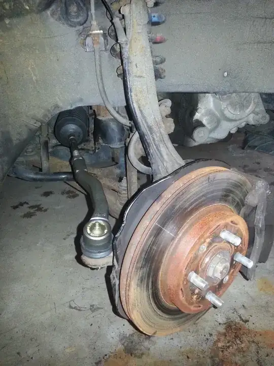

Goal: install tie-rod 'bellows' boot.
Having unusual difficulty seating the inner (larger side) boot on the steering assembly. Unable to see and must do it by feel because this Acura only has access form the side \ wheel well with limited space
Seeking tips for seating the inner side of the boot. Using OEM bellows: expecting maximum probability of a proper fit
If you have had success using a particular technique installing a tie rod boot: please state this in your response. Double bonus if experience includes an Integra \ Civic. Thank you
UPDATE: SUCCESSFUL INSTALL
