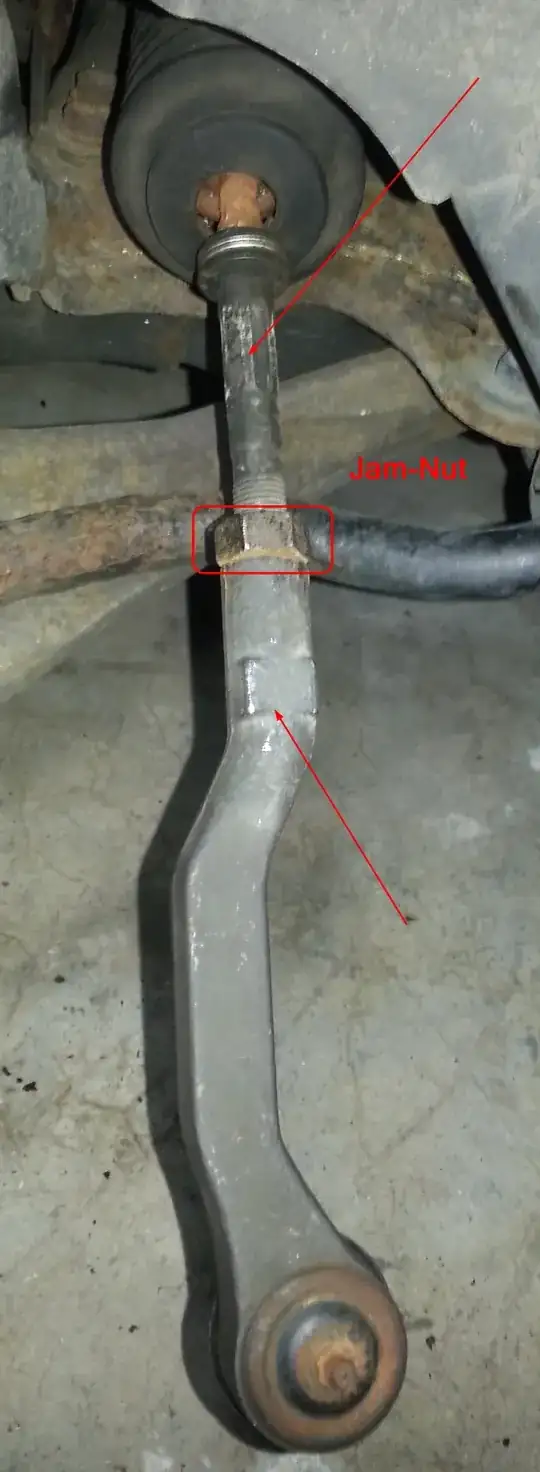

GOAL: 95 Acura Integra left inner+outer tie-rod replacement. This challenge was identified after resolving: Difficulty removing Outer Tie Rod from steering knuckle
  • Outer tie rod removed from steering knuckle (see photo)
  • Jam-nut loosened (red-box in photo)
Uppermost part of rod is in a rotating socket (similar to a human arm). Attempts to remove and disconnect the outer tie rod by applying wrenches at the upper and lower arrows are unsuccessful because the assembly is in the rotating socket
**Seeking advice \ clever techniques to remove tie rod assembly: ** How to unscrew the outer tie rod from the inner tie rod, or unscrewing the inner tie rod from the steering assembly?
I am under the impression it is necessary to unscrew the outer tie rod so that the tie-rod tool can be slipped over the inner tie rod and unscrew the inner tie rod. I hope this is incorrect and there is a clever method to unscrew the entire assembly from the inner tie rod.

2 things about removing inner tie-rods:
  • Yes, the outer tie-rod (tie-rod end) needs to come off first in order for most tie-rod removal tools to go on
  • In my experience, tie-rod removal tools don't have the grip to handle the amount of torque needed to remove a tie-rod that is seized with rust and age. I've tried them but ended up using a pipe wrench. One inner tie-rod was seized so badly, I needed to brace my shoulders against a wall and roar like King Kong while pushing the pipe wrench with my foot. I call this technique "gas pedaling it."

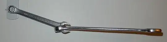

  • get more leverage. Use tools with longer handles. If using a socket, get a 24" breaker bar. If using a pipe wrench, get an 18". If using a regular open-end wrench, use a 2nd-one for added leverage like this
