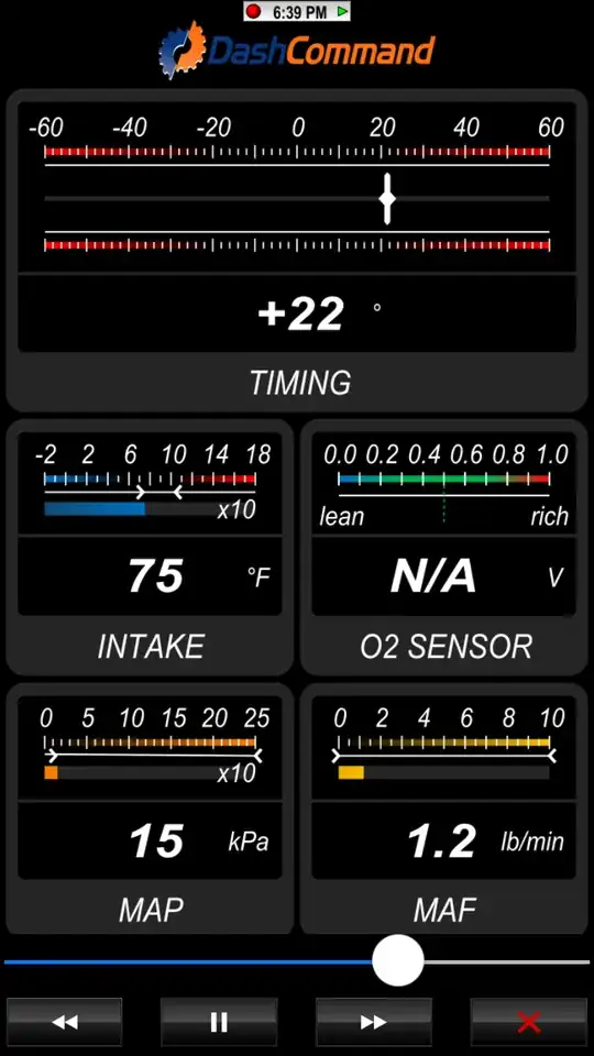

UPDATE I got some more info off an app on my smartphone connected to my OBDII port. I see O2 sensor is N/A! That means that I can't see how lean the engine is running - that should mean it's the sensor that's broken now right?
Here's a screenshot:
OBDII
Wow, sorry its so big!

  4. The oxygen sensor is reading incorrectly, and everything is actually fine.
1 would generally have to be a leaking injector or a wiring/computer fault. The computer should automatically adjust the firing time of the injectors to achieve the proper ratio based on feedback from the O2 sensor. The fact that it's throwing that code means that it's trying and unable to adjust sufficiently to keep the air/fuel ratio correct.
2 is easy to check- make sure the air filter is clean and there are no obstructions in the intake path.
3 Check the spark plugs, check the plug wires, check the coils, check the wires feeding the coils. The Internet leads me to believe that your ignition might be coil on plug, in which case there are no plug wires. Generally a spark failure should be detected by the engine computer and logged as a misfire, especially if it were bad enough to cause a rich condition, so this one seems less likely. (I'm also assuming you don't have a diesel engine.)
4 could be the issue, but O2 sensors are a pain to access and require a special socket to remove/install, so I wouldn't just jump to that on a whim.
