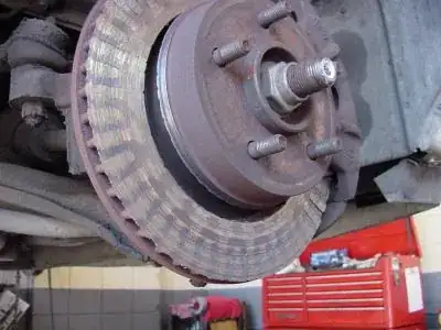

So here's what I've learned in the past couple of days.
Apparently there is a simple way of assessing the condition of brake discs/rotors. For every car there is a minimum thickness for the brake discs. Once they get below that thickness it's safe to say that they're past their lifetime. For my specific model (Fiat Punto 2001 Sporting) that thickness is 10.2mm. I found this info in a Haynes manual for the vehicle. It's not too hard to find the same info for any other car.
The car braking fine is not a good indicator of the condition of the brake discs since it's quite possible to use them and the brake pads until their very physical end without noticeable issues.
Example:
Worn discs
There are many videos on YouTube that explain how one can accurately measure the thickness of their brake discs.
Checking the thickness is not the only way to assess the condition of a brake disc but it is the easiest and most indicative assessment approach for a rookie.
Mine were indeed below their minimum thickness.
