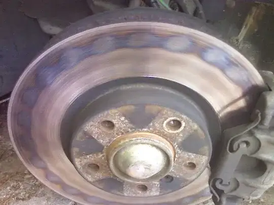

Let's say you take off the wheel (when replacing the pads, for example) and look at the brake rotor. What are the signs that it's time to replace the disc?
Let's stick to clear visual signs that don't need extra special equipment or driving the car and listening/feeling to notice, such as slight warping.

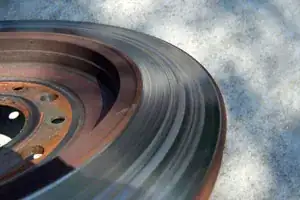

  • Scoring
Bad

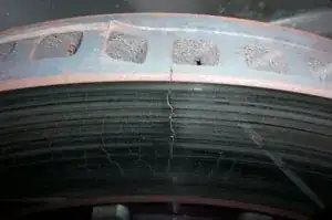

  • Cracks
Very bad

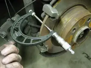

  • Low thickness
What's depicted here is not necessarily bad

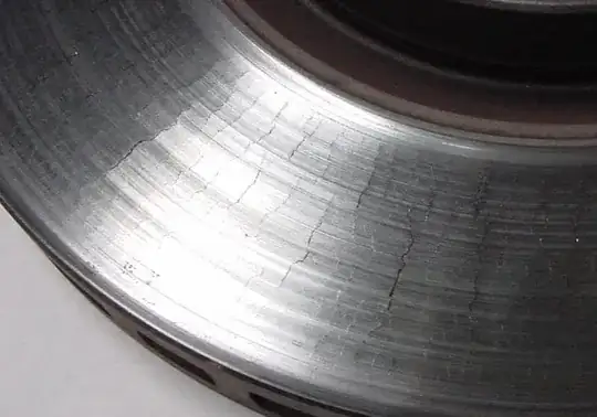

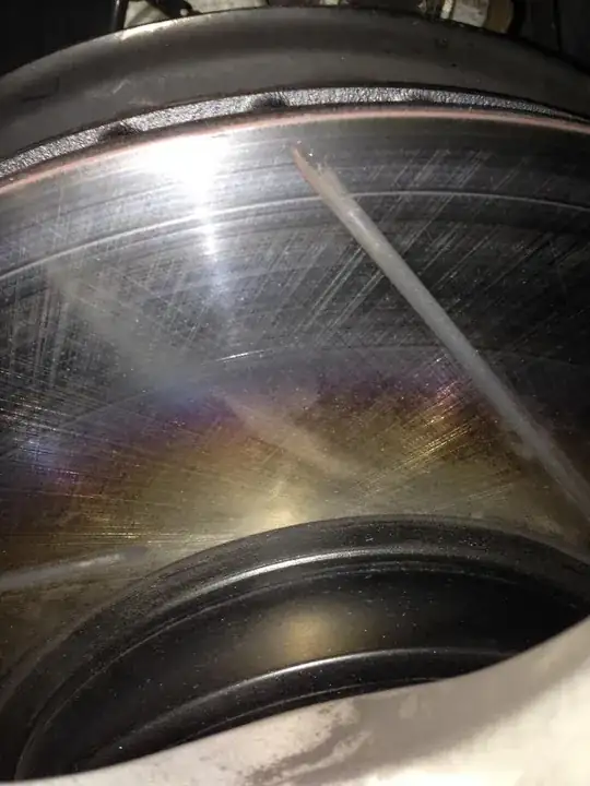

Overheated rotors can show some tell-tale signs. Once the metal has been overheated, it can weaken or warp which are both bad things. Some signs:
Bluing
Cracks
These "spider cracks", "heat cracks", or "heat checks" are only on the surface of the rotor, but are still bad.
