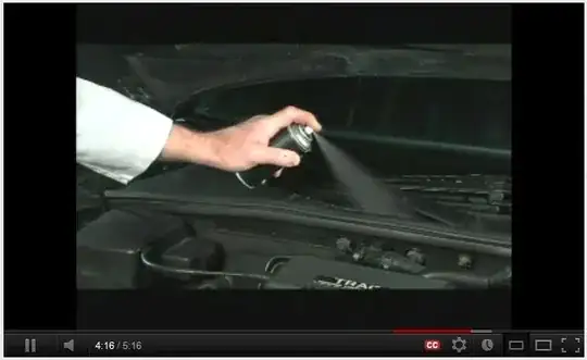

i'm looking to remove an odor from my Corolla's fresh air intake.
There are products available where you spray the product into the fresh air intake (near the windshield wipers), while the fan is running full speed:

Now the idea of spraying an aerosol into my car's electric fan makes me kind of nervous:
  • the product in the spray can is (almost certainly) flammable and explosive - yet Toyota itself uses the same thing
  • i've also seen videos of people spraying Lysol into their fresh air intake to remove odors. A can of Lysol can double as a flame-thrower for those with too much time on their hands
  • i also bought a can of AC deodorizer that contains iso-butanol; and has flammable warnings on the can
  • and finally we have Toyota recommending spraying isopropyl alcohol (i.e. rubbing alcohol) into your intake
