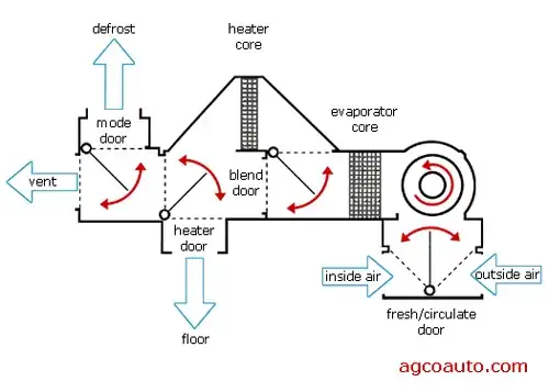

Edit: found this illustration on agcoauto.com, which basically confirms what sweber wrote:

The reason for the odor is that water condenses inside the ducts when the AC cools the air. Though there are drains, there will still be enough moisture in the system to allow mold to grow.
The heating is usually placed after the AC. This is useful for screen defogging: The air is first dehumidified by the AC and then heated, which gives warm, extremely dry air. The other way, dehumidifying would not work.
So I think you can't cook your mold, because it's sitting in the AC system, which you can't heat.
Furthermore, mold dies when the temperature rises above 70°C for a longer period, may be one or two hours. This heavily depends on the type of the mold. Coolant of a warm motor typically has about 80-90°C, but it's possible that it has already cooled down a little when it flows into the heating part of the HVAC system. And the air may also not be fully heated to the temperature of the coolant. So, it's possible that the hot air is not hot enough to kill the mold. However, the air would be hottest for lowest fan speed.
So, contrary to the answer you linked, I don't see how heating can help to dry the entire system. It only helps to dry the ducts between heater and vents, but not to dry the AC.
The other answer is better: Run the system (also at high fan speed) without AC for some minutes to get as much humidity as possible out of the system.
