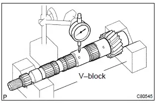

You would want to use a dial indicator and a pair of vblocks
In order to understand the amount of run-out you may have on your axle you will want to be able to measure the amount of run-out and you have on the axle.
You could roll it back and forth on a flat surface to get a general idea if the axle is bent but ultimately, to fully understand the issue empirically, you will need to measure the run-out.
This tool pair will allow you to do it.
The manufacturer of your bike will have the service limits of runout listed in the shop manual.
