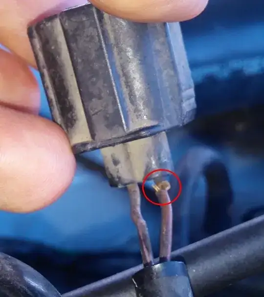

So I went to look at the IAT connector and found this:
The wire seems to be made of four strands, two of which are broken and probably making intermittent contact.
I'm going to go look for a good connector from a junk yard and splice it in, however, I'm not sure this is really the source of the problem for a few reasons. If I completely disconnect the IAT sensor the car starts up just fine, so I don't think that frayed wire would cause an intermittent ECU problem, would it? Looking at "Cranks Normally But Will Not Start" in the troubleshooting section of the WSM it does mention a few problems where a short to ground can be a cause, like with VREF and an "IG" line from the DLC, but I don't have a short to ground here, I've got a partial open.

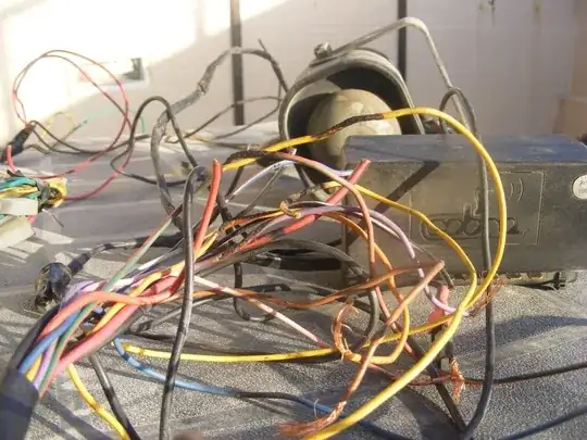

The other thing that's making me suspicious is an aftermarket keypad immobilizer that's been installed in addition to the factory key chip immobilizer. I remember the previous owner saying he had disabled it because it had been causing him problems, however it is still physically wired into the system under the dash ( it's a nasty rat's nest of spliced wires under there ) and I'm wondering if maybe it's haunting me from the grave so to speak.

So I spliced in the new IAT connector, cleared the codes, ran the KOEO and KOER self tests, and so far so good. Not sure what to make of it. I was thinking of pulling the ECU out to visually inspect it, but maybe I'll just keep an eye on things in the mean time and see what happens.

So basically, the problem was shorted out wires in the Cobra alarm system which were causing the alarm system to randomly disconnect the ECU, fuel pump, etc:
I'm not going to copy the full answer here, you can read it over on this other question.

The break in the wire could have possibly been causing a spike which was scrambling the ECU. I suspect that the problem won't occur anymore since you've changed that bit of loom.
