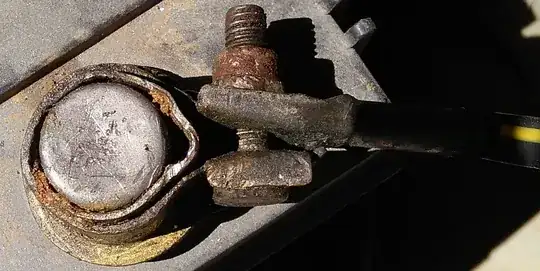

Then today, I revved the engine hard, it stumbled and almost died, then the battery light came on. Got out to check and saw 13.75 volts, with a reading of between 0.02 to 0.04 volts between the negative terminal and the alternator casing.
I'm thinking maybe there is a problem with the connection to negative post, and both these events jostled it enough to cause a problem.
Here's a picture of the negative post:
I guess I'm going to try and clean the connector and maybe sand the inside of it to see if that helps.

OK, so cleaning and sanding down the inside of the connector and the post didn't help. I wonder if these two events might have caused some of electrical surge that screwed up a diode somewhere or something strange like that?
