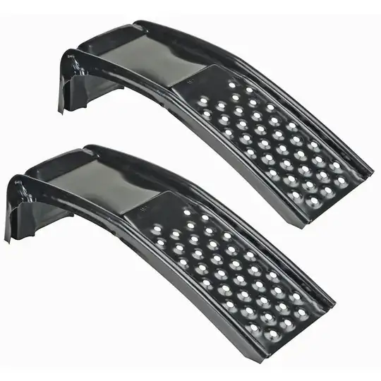

I have a very smooth garage floor. When I try to use my wheel ramps for the quick and easy way to raise a vehicle, they will often slide, sometimes just one, but other times both. They will sometimes even continue to slide as the tire pushes them forward. What is an easy/safe way to keep them from sliding?

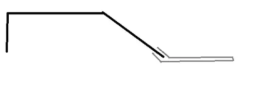

Duct Tape. Of course.
Take a piece of duct tape and tape it to the lip of the ramp. Run it out 12 inches/30cm and then fold it over and run it back to the ramp. Stick this on the backside of the ramp.
As you roll up on the ramp, the tape will be trapped underneath your tire and the ramp will be unable to slide away.
