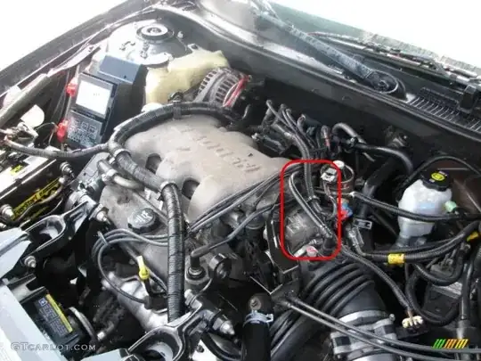

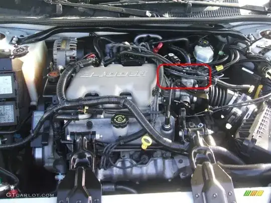

First, is this a PCV (positive crankcase ventilation) valve tube on the 2002 Chevrolet Impala?
It is hard, non-flexible plastic with hard rubbery grommet-like inserts on the ends, with one side going into the air intake just before the throttle body, and the other inserting into a metal casing on the back of the engine.
Ours broke in the middle while removing to change the coolant thermostat, which is below the throttle body.
Below are some pictures found on the internet, in which I indicate the relevant tube in red:

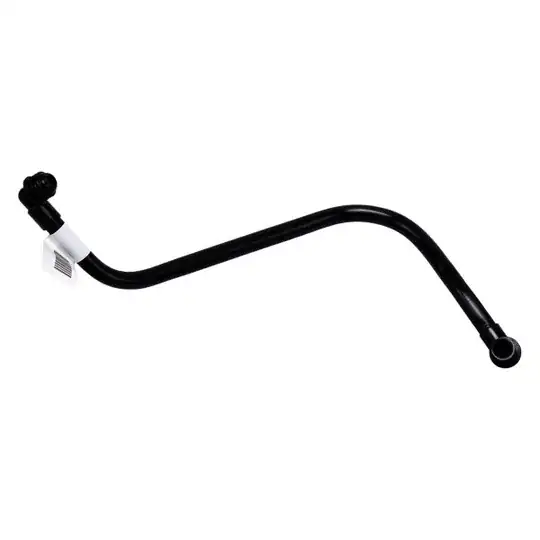

It appears similar to GM part #24508188 :

If you are in dire need for a replacement on the cheap, either way you suggested would work just fine. In fact, if you used fuel line (or any other rubber based line which fits over the hard plastic), you probably wouldn't even need to secure it. The right sized hose would secure it self. The hard line just has to slide into the hose, so the same inside diameter of the rubber hose to the outside diameter of the hard line would work just fine. To allow it to work, it just needs to have an air passage in between. This area gets no hotter than the underside of the hood during operation, which is warm, but not excessively so. The part doesn't (or shouldn't) run against anything which is extremely hot, so should be good to go. Tape would be just fine as well, but would most likely deteriorate faster. Good duct tape would do the job, though.
