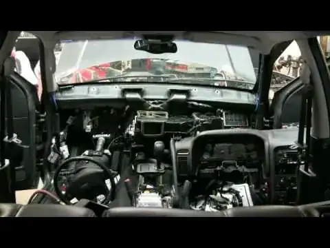

If you have to tear out your dash, more than likely, to get to the problem door it may bring tears to your eyes due to the intense emotional and intellectual pain it can create within you. I suggest keeping hammers and other heavy objects that can be thrown out of arms reach.
This what your dash will look like when it's torn out
