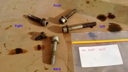

Documenting through photographs can be painstaking and time-consuming, but I consider them essential where sequence is confusing or location is critical. This photo of my E39 M5 oil pump bolts turned out to be well worth the effort when the time came to button it up.
E39 Oil Pump Bolts
