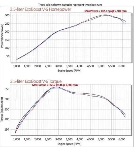

The amount of acceleration you feel depends on the amount of power the engine can deliver, and the speed you're driving at.
Power
Internal combustion engines are more efficient at some speeds than others. To illustrate, here's a random power and torque curve:
Torque curve
Torque (which is the property you feel when you accelerate) peaks around 3000 rpm, and then starts to drop: the engine gets less efficient at higher rpm.
Speed
Drag increases with the cube of speed, so it rises quickly when you accelerate. The faster you go, the more difficult it becomes to accelerate (the more torque you need). At some point, all of the engine's torque is spent counteracting drag (and other losses), and none is available anymore to accelerate.
