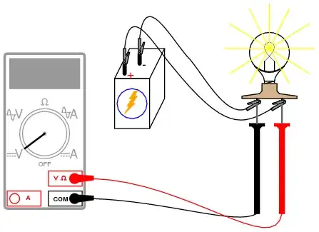

Voltmeter Mode
http://sub.allaboutcircuits.com/images/05078.png
In Voltmeter mode you must always perform measurements in parallel with the circuit being measured, the circuit is powered
The basic functionality of the voltmeter is to measure voltages, potential differences across two points in the circuit. Virtualy all DMM's will have voltmeter functionality.
On the representative device shown in the image, the voltmeter modes are selected between 9:00 and 1:00 on the clock face. The flat bar represents DC mode and the Wiggly Line represents AC current. Either mode can safely be used interchangeably (affecting only reading accuracy) provided the voltage ratings are respected. Some multimeters will offer autoranging feature that does not require you to select the range explicitly on the dial.
Some ways you can use the DMM in voltmeter mode for automotive purposes
  • Establishing the presence of a control voltage on a signal line e.g. relay control line, fuel injectors
  • Establishing the presence of a supply voltage on various circuits
  • Measuring the voltage output of the regulator/alternator or battery
