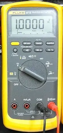

To track down and troubleshoot electrical issues, you will almost certainly need a multimeter (also known as a Volt-Ohm meter) - digital ones are best, like the one illustrated below (from Wikipedia)
Fluke Multimeter, courtesy of Wikipedia
You can get cheap ones, which are fine for most automotive stuff, or much more expensive ones with all sorts of clever features.
The two most useful things for car work are the DC voltage setting (The V with solid and broken lines above, at 10 o'clock on the above picture), and the continuity tester setting (the sound-wave and ohm symbol at 12 o'clock)

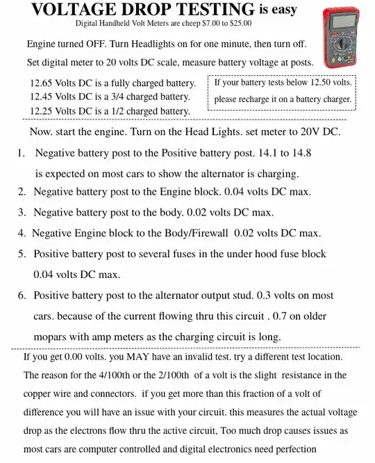

https://www.reddit.com/user/waynep712222
Created by Reddit User Waynep712222
