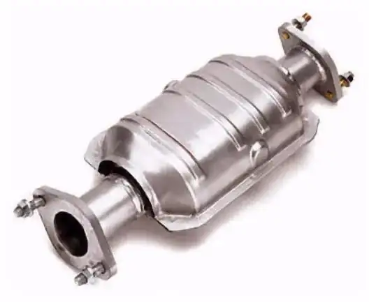

Catalytic Converter
It is a funny looking thing. This is one of those things that I often hear about but still don't really understand what it does.

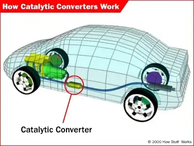

Catalytic converter location
It is a device in the exhaust path of your car that scrubs unwanted gases from the exhaust stream.
