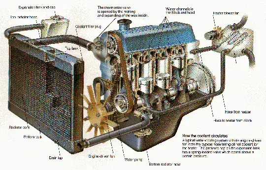

What is engine coolant?
Engine coolant is a water and antifreeze solution. Because water has good properties as a coolant, antifreeze is used in internal combustion engines and other heat transfer applications, such as HVAC chillers and solar water heaters. The purpose of antifreeze is to prevent a rigid enclosure from bursting due to expansion when water freezes.
Cooling System
As the coolant is moved around the system by the water pump, it passes through two main components:
  • Radiator - The cars air intake is used to dissipate heat (which is easier across a larger surface area, higher fin density and thicker radiators - much like in PC water cooling). This is able to keep the engine coolant cool.
  • Engine Block - This is the main part that the coolant is designed to wick away heat from, by flowing through engine hot spots and allowing the heat to transfer from the engine oil to the coolant as well in the process.

    • Interior car heater will lose functionality - The heater functions based on the engine coolant, as seen in the diagram above.

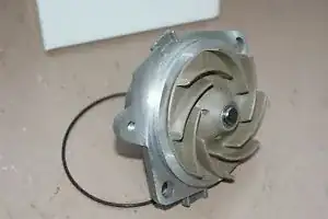

NOTHING will happen if that lower amount wont cause overheating. For example in my country winters are very cold about minus 32 degrees Celsius. My car to get warm it takes about 30 minutes. It's Italian car and it very bad at warming up in winter. So i use less amount of coolant so this amount heats faster. And impossible to overheat car because when thermostat opens cold coolant from radiator makes coolant cold again and car never overheats. People here just makes worst scenarios. witch is not possible if your coolant temp is in normal range - 90c. Also fairy tales about water pumps is stupid. Water pump is just bearing that is driven by belt. Bearing rotates plastic stuff that makes water flow. Maybe in other cars it's different in mine there is no actual pump. SO if there would be no coolant, which is impossible based on your question - it wont broke.
Waterpump.
