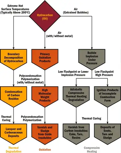

As whatever limited oil is in the engine is pushed around, it becomes hotter and hotter. It becomes hotter because the oil isn't allowed enough time to cool down a little before it is required to go back into the engine and do its thing. As this happens, the oil will wear out faster. Fully synthetic oil will last longer than dino (refined) oil, but it will suffer defeat sooner or later as well. Several reactions happen to the oil, to include oxidation, thermal degradation, and compressive heating. Mind you, all of these things are created under normal use conditions (and thus the reason we change oils when we should), but under extreme conditions as you've suggested, it all happens much faster.
This is a great image which describes what happens from the Machinery Lubrication website -
All of this breakdown creates the regular: tar; sludge; varnish; soot; etc. All of these things start depositing on the internals of your engine, such as the rings, bearings, cylinder walls ... anywhere oil would normally flow. If you go back to your chemistry teachings, you'll probably remember that a large portion of oil is carbon. All of the previously mentioned nasty substances are actually a carbon byproducts. As these carbon substances continue to deposit, any part which comes in contact with them gets wear on them as carbon can become quite hard and/or sticky under the right circumstances. This starts creating more friction on these parts. So now instead of cooling/lubricating/cleaning, the oil has broken down is now heating (due to more friction), creating deposits, and making the engine a really filthy place. You should realize it is now doing everything it was originally meant to replace.
